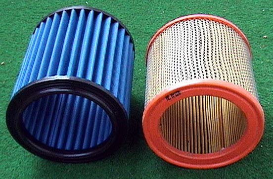

I've also done my own variant of airbox uppgrade. Basically it's very much like the Evoluzione oversize air box upgrade kit, but I don't fancy paying $160 for an aluminum spacer ring!
No, no!
I make it myself!
First I went to my local car tuning shop (BSR to get me a free flow sport air filter. I ended up with a JR Filters R95138.
Specifications (compared to original) :
Outer diameter 125 (124) mm
Total height with flange 140 (118) mm
Filter body height 132 (118) mm
Material: 4 layer of specially oiled chirurgical cotton, which are hold together by 2 layers of steel wire mesh, all folded between rubber top and bottom (folded paper between rubber top and bottom)

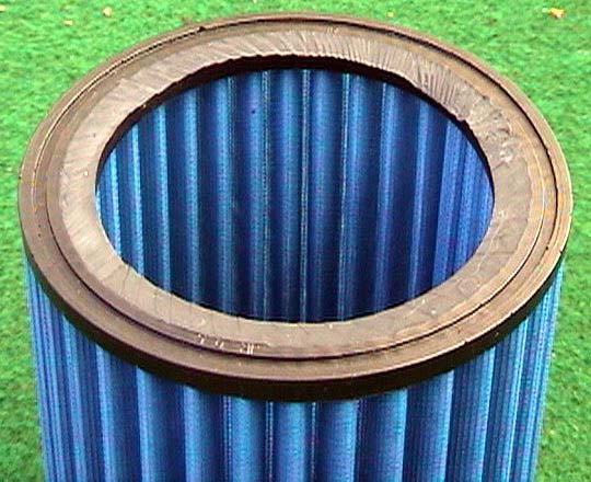

I had to remove the flanges of the new filter with a scalpell to get a tight fit in the outside of the hole. See pictures. The marginally wider filter make it fit even tighter than original.
After removing the flanges on both sides of the filter, it now has a total height of 132 mm, wich is 14 mm more than the original filter. => the airbox will have to expand 14 mm on the height.
The fit between the upper lid and lower bottom of the airbox fits inside each other, with a 4 mm overlap. I.e. I need a distance ring with a height of 10 mm. I searched for waterproof plywood in 8-10 mm thickness but didn't find any, so I had to suffice with standard quality of plywood (which is pretty weak). I took my power saw (?) and roughly sawed out the form of the airbox. Then i mounted the plywood ring to the airbox lid with screws and nuts, this way it was a lot easyer to work with the fragile plywood ring, and realy easy to file out the exact shape. I didn't want to leave too much extra material inside the airbox because it might hamper air flow, and I could not leave much extra material outside the airbox because it is a real tight fit underneath the tank. This is what the result looks like:
The plywood i got has a thickness of 8.5 mm, which I consider pretty ideal although I want a thickness of 10 mm. Because I don't have the waterproof type of plywood and because I want the distance ring to have a somewhat soft surface to get a good seal, I carefully wrapped the plywood ring in a couple of layers of silver tape and insulating tape. The result is a thickness of 10 mm, with soft gasket like surface which is also waterproof.
I choose to keep the insulation under the tank, beacause I think it's so soft it will deform while fastening the tank. Just as in the Evoluzione kit I had to get longer screws. To be more precise, 7 x 30 mm M5 and 2 x 40 mm M6, I choose stainless steel. It takes 2 distances (12 mm) around the M6 screws that hold the tank to the frame. This means the distance between tank and frame are bigger. It doesn't look bad at all, but if the extra distance is more than 15 mm it doesn't look good.
And the best of all: It really works! I really feel the extra torque and power over the whole rev range. And the power delivery is smoother than before, not as rough in low revs as standard. I don't know if it is better or worse than Evoluziones kit but at a total cost of only �48, of wich �42 are for the airfilter and the rest for plywood, screws, etc, it's without a doubt a find!

* VOLUME: Bigger is better. Standard airbox < enlarged airbox < airbox with tank as top cover < open airbox.
* CLOSED OR OPEN AIRBOX: Well here's an old tricky question! There are plenty of pros and cons; Ram air, Maximum possible flow, Warm/cold air at standstill and/or moving, turbulence and so on... I don't really know what's the best.
MY OWN conclusion is to use extra big (+14 mm) oiled cotton filter for best filtering & flow, retain the sealed airbox for convenience and ramair effect. This is a low cost, high performance, no risk solution.
This is my DIY solution and it works fine for me. I don't urge anyone to do as I did. Everyone has to make their own decision on what they want and take the responsability of that decision.

I bought an Evo filter for the early model RSV as it is taller and flows more and it comes with a rubber ring to seal the top of it. I held it in place with a section of 1 inch foam rubber which I stuck to the top of it. The tank very firmly holds it in place.

Also, if you do the home job, or if you do buy the Evo kit, make sure you order the 2000 style filter as it is taller and flows more air than the 2001 filter.
Actually, If you wanted to spend some money unnessicarily and didnt care about the questionable sealing properties. I think you could simply buy and use the race kit portion of the EVO kit for $20. You dont seem to need the $159 section. All you need to do is make the plywood ring to hold it in place. (Initially I was going to try and copy the Evo style and use a 2-3mm thick sheet of Butinol roofing rubber as the seal and use a piece of plastic perspex and cut it into shape to hold it in place. Then the foam idea hit me)
But personally I'd just use the foam rubber seal around the edge as it works fine.
