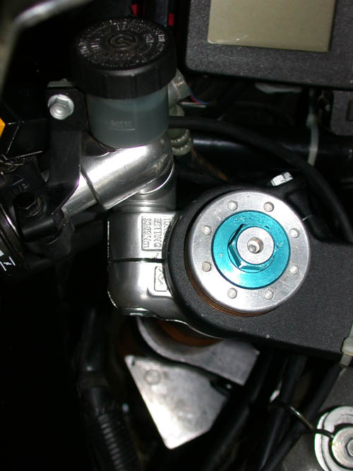

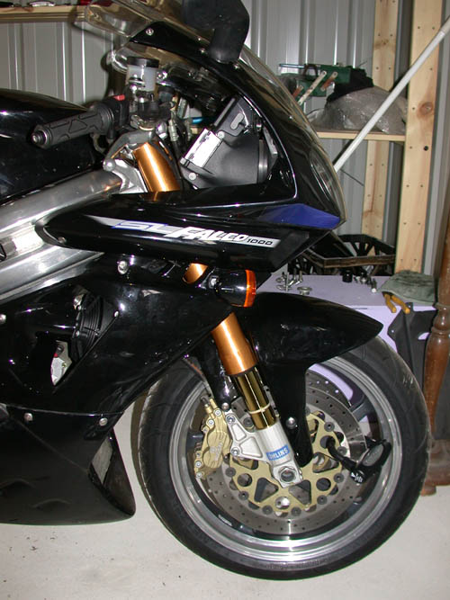

Well here is some Pic's of the forks and Tomaselli bars.
The total time to get the Showas off and the Ohlins on (5 hours) is a bit long winded, so I won't go into mutch detail, unless you guys really want to know, suffice to say that the hardest bits were figuring out how is was going to support the bike once the forks were out, and getting the new bearings on, and the corresponding shells out of the stem.
I put the bike on it's rear stand and put a 1 tonne car support spaced up under the clutch asembly, as well as a car scissor jack under the "flatest part" of the oil sump. This actually worked extremely well!
Getting the new bearings on, and the shells out proved the hardest, as the new hard chromed bit at the top of the stem was now the same dimension as the bottom surface, so to get the bottom bearing over the top surface I had to put the steering stem in the freezer for about an hour (to shrink the thing as much as possible), and to get my wife's hairdryer and heat the bearing as much as I could. It finally went over the top surface after much tentative hammering all around a drift, over the stem rod.
Getting the old "other half of the bearing", the shell inside the frame steering head, proved somewhat difficult as well. After much careful persuasion, they came out and then after a short time in the freezer they went in quite easily.
Next a grease with aircraft quality grease, and tighten the steering stem up.
All is going according to plane!
Next the forks went in, and the handlebars, measured 3 rings on the top and set the top triple clamp on. (I'm having a small aluminium block machined up for the ignition switch, that's why you can see some cable ties holding it temporarily - the previous owner raced the bike and ground off the previous ignition block - I may save up for a top triple clamp from a guy in South Autralia, who did the ones for my old ducati). Frankings Racing. Some really beautiful stuff.
The next problem I had was, that I didn't have any mounting bolts for the rotors. Looked at my 4 spot calipers on my old Duke, right size, wrong thread. Quick trip up to the local bike shop with fingers crossed. 4 Bolts sourced, PHEW!
Anyway didn't get to ride the bike on Saturday as the missus's went for a hair appointment, so my turn for the babysit/fun with my 16 mon th old. (She can have as many hairdo's and whenever, seeing I can have the Ohlins - GREAT DEAL, I RECKON!)
Went for the ride, on Sunday (Took some tools just to make sure all bolts were tighten, and I could adjust the suspension if necessary). Initial impressions, very impressive, I repeat very impressive! Wound on another turn of preload, only. That's why you can see the cale tie on the leg.
Didn't have the luxury of 2 friends to help without the static sag measurement and had to do via experience rather than exact science to later in the week. (Temp solution I know - but would this stop you from going for a ride! ). I was really surprised that so far I can't fault the settings for compression, rebound, and my preload, at this stage. Remember I wanted to get used to the ride before having a really good thash. We did however up the pace to probably 65%. I also was wearing in some new M1's so just wanted to err on the side of caution.
The Tomasselli, I guess in word, look cheap, compared to the Gille's, and Heli bars. They also are slightly lower, but I just set them initialy and so far aren't too bad, (I have long arms), But again some custom bars from Franks Racing would set the bike off very nicely.
Anyway I'll get some better photo's over the coming weeks.

Well, Ex, you've outdone yourself with this one. Pheeuw! What a site for sore eyes! I can only imagine how that must look on a red Falco.
I'm missing some gold-coloured OZ wheels on your bike. And of course, the TNT system.
1. These forks are designed for the more skillful riders among us. I'm not convinced I'd get the most benefit out of them but then again, I don't do many trackdays. If you do, good on ya!
2. I'd be shitting myself if I were to ride an '03 Mille R every time a c*r or truck came up behind me. It's the only way to total them and keep the front intact.
Congratulations! Now for that system....
