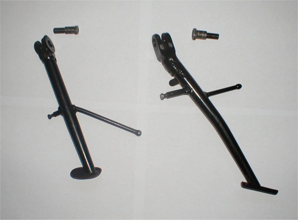

Having acquired a GSXR600 side stand I have a little more info re this potential mod.

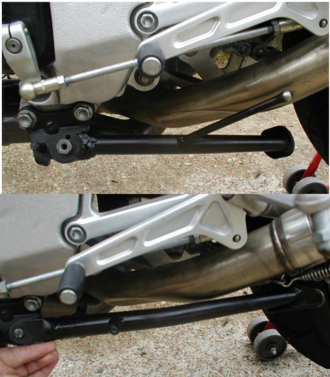

After fitting an Ohlins rear shock the ride height increased about 10mm, making parking on the side stand a decidedly iffy experience necessitating the carrying of a 3 inch square10mm wood plate. As you can see from the pics the GSXR stand improves the stability to that which you would expect of a quality bike, the stand is actually �engineered� with welded support plates and some great looking curves. The first pic shows a comparison between the OEM and the GSXR stands.
However if anyone thought that this was going to be a straight bolt on mod then think again. The first problem is going to get it bolted to the Falco mounting plate, whilst they both use a 10mm bolt the shoulders are of different diameters and they fix from opposite sides. This is relatively easy to overcome by either turning the shoulder of the mounting bolt down to suit the Falco mounting plate or by enlarging the mounting plate hole to suit the bolt. The next problem is the side stand switch. This is fixed as standard by an 8mm(?) bolt that screws into a threaded hole in the head of the OEM mounting bolt. As the GSXR stand is bolted through from the opposite side it would require an 8mm hole to be drilled and tapped in the end of it, which I don�t think is feasible. Of course the switch could be disconnected altogether but I�m one of those that finds this safety device very useful. Another approach could be to mount a plunger type switch (probably a hell of a lot better than the standard switch) and rewire it. Once you�ve dealt with all the above all you need to do is to is reposition the spring hanger and the kickdown bar. As far as ground clearance is concerned I would say that the GSXR stand would be little worse than the OEM one but this is a subjective opinion as its rather difficult to say just by looking at it.

Red, looks like you've got the bike propped up in the 2nd photo with the foot of the stand 2 or 3 inches off the ground, is that correct and if so, is it stable when on the stand? Looks like it may not be worth the trouble?
Sorry, don't mean to belittle your good work
By Redlionfalco on Sunday, November 03, 2002 - 04:49 pm: ![]() ![]() ![]() |
I can confirm that both pics are of the bike being supported by the side stand - NO props.

Could you post pictures of the sidestand in its riding position, and maybe some picture of the sidestandswitch mod. Thanks a lot!

By Redlionfalco on Monday, November 04, 2002 - 12:23 pm: ![]() ![]() ![]() |
That 'red thingy' is my track stand. I have to confess to not knowing for sure the model and year that the GSXR stand came from but I will try and confirm these details, but I think it was a Y2k GSXR600. The picture shows the difference between the stands when they are in the up position. Its actually quite hard to get a perspective on the relevant positions from the pic but the end of the GSXR stand is further to the rear, higher and further outboard than the original. In the down position the GSXR stand is 95mm further outboard than the original and if you take account of the fact that the contact point for the ground on the original is at the inboard end of the plate then the difference becomes nearer 125mm. Practically this means that it is now a struggle to lift the rear wheel off the ground by tipping against the side stand, a measure of the improved stability.

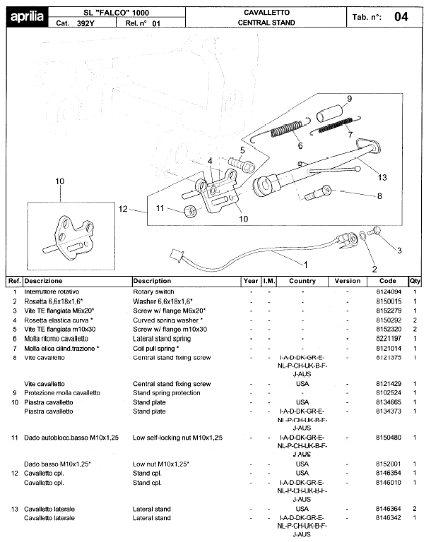

One way to make the sidestand wider is to get the USA-version. If I'm correctly informed it extends further out from the bikes center line. Look at the Spare Parts Catalogue:
If you have changed the shock to a longer one, you probably need something else, as sugested above.

I guess I was being too obtuse. The parts list above shows the quantity '2' for the sidestand for the US bikes, but only one for the rest of the world. Obviously, we don't need two sidestands on a bike. Sorry.

Inspired by Cplus immaculate observations I just discovered another weird thing!
Aprilia obviously thinks this is a "Central Stand"!!!
That makes me wondering how unstable the bike would be on what Aprilia would call "Side Stand"???

A closer inspection of the parts list suggests that there is more to the conversion than just changing the stand plate (part 10) as I first envisaged. Parts 8, 11 and 13 (the bolt, stand and nut respectively) all have a different part Nos. for the USA. Does anyone know if there is a difference in the parts, especially the stand. It may be that due to the different plate it could be a different length or shape
