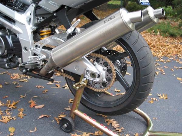

Mine isn't nicely polished, and I haven't gone for a shakedown run yet so I can't rave about the Ohlins or how big a difference the 16/43 Sprocket Specialists sprockets and DID chain make, but I do have pictures!
(Let's see if I can post 'em!)

Okay, yesterday we had snow flurries so I didn't get to out for a shakedown run. Today was cool (45f) but clear so I wanted to get out and see how everything worked. Below are my impressions after a 45 minute ride.
But first, I should mention that I have no idea what spring rate this shock has. Whatever comes stock with a 2001 RSV-R, I guess. I've e-mailed PPS and Ohlins USA, but I haven't heard from either in over a week so I'm not holding my breath. I did call Aprilia USA and they confirmed that there was a change to the Milles between 2000 and 2001, but they couldn't tell what the changes were or even what the changes were meant to accomplish. The person I spoke with knew that the shock should be fine for someone between 165 and 195lbs, but not much more. Aparently Aprilia Italy isn't too forthcoming with information.
Back to the show. Right away, it seemed like the back end was a little higher. I didn't measure the ride height before switching everything, but the shock was only about 2mm longer (~321mm for the Ohlins vs ~319 for the Sucks) so it shouldn't have been a big change. This isn't a big deal for me as I have a 32" inseam, but it could present a problem for shorter riders. Kinda like a Mille.
It took a few good twisty roads to appreciate how much better the Ohlins works than the stocker. Okay, the roads weren't all that good -- they were pretty crappy in fact -- but that's where the difference showed up most. With the bike cranked over through pot-holed bends the back stayed composed. I was pushing hard enough to get a few little wiggles through the bars going over the bumps, but the back just stayed planted. Very nice. I didn't push much harder because it was still only about 45f and there were wet leaves on the roads.
'Composed' really does seem to be the best way to describe the new shock. No matter what I threw at it, the rear never got out of shape. More hard riding is the only way to make sure that it's all good, but initial results are promising. Oh, yeah, all this on the stock settings.
The other change was going to a 43t rear sprocket. This really goes a long way towards fixing on the of the few issues I had with the Falco. It was just geared too tall for my tastes. With the 43t rear sprocket, the first four gears are more suited to how I ride in the twisties and 5th and 6th gear are more usable for highway droaning.
A few folks have expressed concern that 16/43 gearing would turn the Falco into a wheelie monster. I guess this all depends on how you ride. Never having been a horn mono maniac myself, I'd say that it's no worse than before. Sure, the front will come up without much effort, but it will also stay on deck if that's what you want.
Okay, now scroll back up to the top of this thread and take a look at the bottom picture. Look closely at the rear axel and chain adjuster. When I switched to the 43t rear, I installed a new chain with one link more than stock. This means that the chain adjuster is closer to it's minimum adjustment range and the wheelbase is a little shorter. If I cut the chain at two links over stock, the adjuster was too close to the maximum end of it's range for my taste. Probably no big deal either way, just thought I'd point it out.
So, was it worth the unmentionable cost and 8+ hours labor? Absolutely.

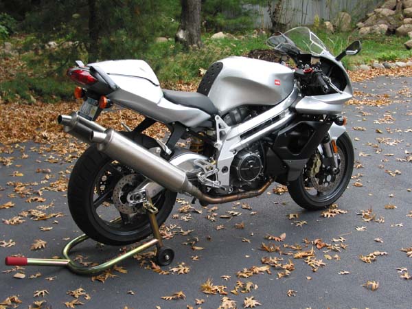

The Powermaster is having a field day with this Mille stuff, you guys!
Meanwhile, see anything Mille in this picture, Mr_Venjer?
By Geo on Tuesday, November 05, 2002 - 01:37 pm: ![]() ![]() ![]() |
Bef asked and I answered:
YES !!!!!!!!!!!!!!!!!!!
( engine, fork, brakes, dashboard)

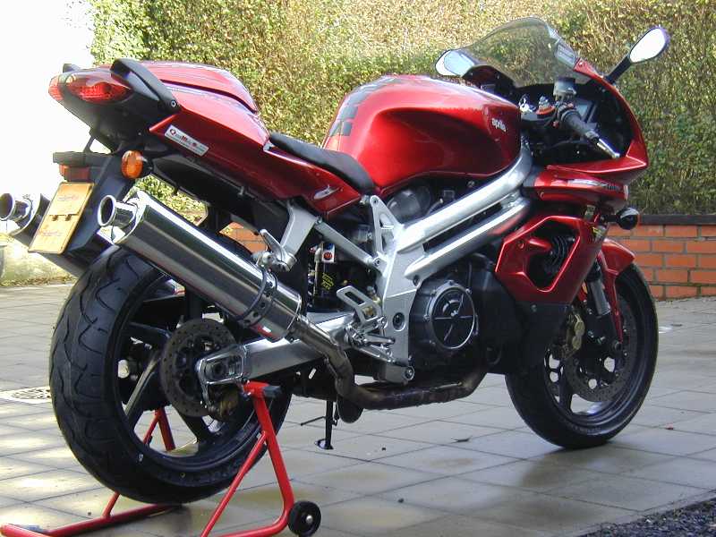

By Crmc33 on Tuesday, November 05, 2002 - 01:45 pm: ![]() ![]() ![]() |
no, the engine is 'retuned' using invisible italian magicary, the forks are lighter and brakes have built in ABS (felt to many as warped rotors) and the dashboard is totally different apart from looking and working the same.
Check it out for yourself, heres my Mille (only used in fair weather)....
I agree that the body work looks similar tho
