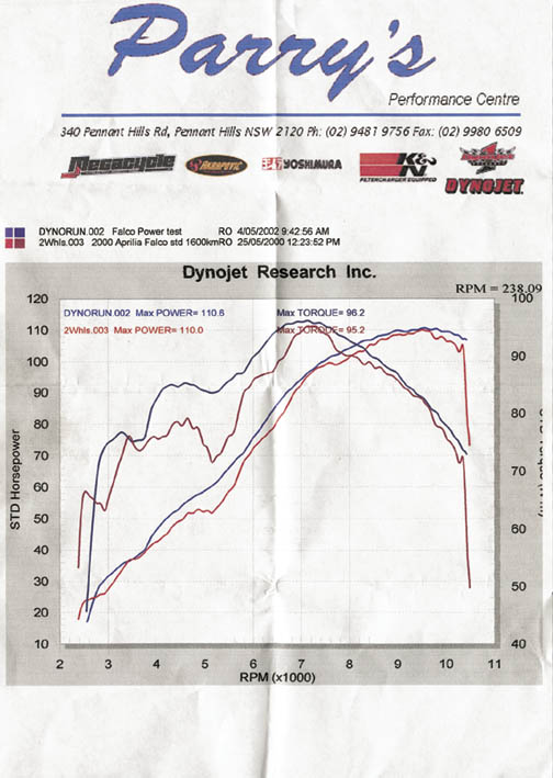

Send the dynos to us and we will print them for you, meanwhile here is a similar test. Look at the power and torque from the Falco.

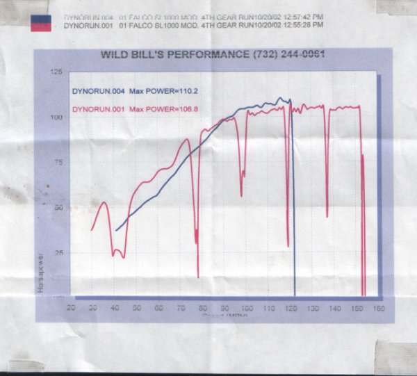

I was trying to upload the whole page and it would not do it. Hopefully by timming it down this will work. The Dyno was a DynoJet and it was rear wheel hp.

By Benw on Tuesday, October 22, 2002 - 12:19 am: ![]() ![]() ![]() |
Looks like it's running a little bit rich at the very top end - maybe leaning it off a little will add some more at peak revs.

By Befbever on Tuesday, October 22, 2002 - 12:34 am: ![]() ![]() ![]() |
Take a Dynojet dyno and all the RSV engines are gonna run rich at the top end. Reason is they're not getting enough air because Dynojet doesn't have proper fans to try and imitate real road conditions.

Why do runs in 4th gear anyway Floormaster?

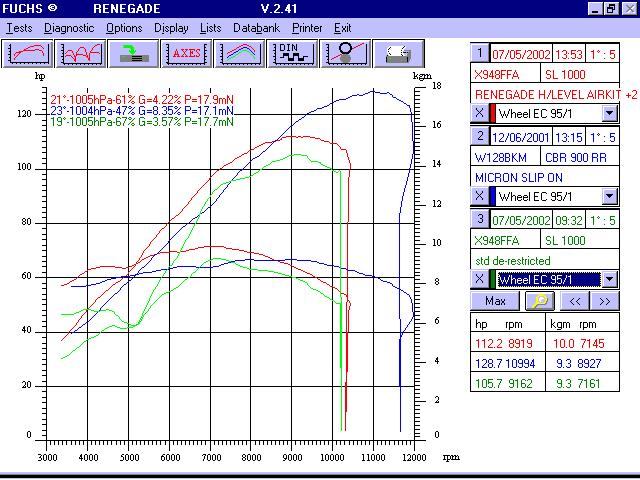

By Exdukenut on Tuesday, October 22, 2002 - 02:35 am: ![]() ![]() ![]() |
Here is mine Apriliafalco for comparison with no known tweaks for your reference, all the way from Australia...
Should just add the red line is with RSC pipes and no airkit, the blue line is Rene's pipe chip and airkit. Hope this helps
By Powermaster on Tuesday, October 22, 2002 - 03:21 am: ![]() ![]() ![]() |
Well done, EDN - thank you!
Also, here is a side by side comparison, scaled identically as close as possible...
It looks to me like we've got results for three different bikes (but near enough identical set up) from three different dynos dispersed across three continents and they all show the same result - so, anybody want to talk about my magic button () NOW?!!!

WOW - Look at the peak output of the Micron equiped graph - 128ish bhp at 11k revs!!! GOTTA!!

Seriously, though, looks like the Micron could help you keep up with the inline 4's, but we could all buy inline 4's and do that! Midrange grunt and torque curve is the stuff, and it looks like Powermaster has tuned his system that way!
By Powermaster on Tuesday, October 22, 2002 - 04:47 am: ![]() ![]() ![]() |
I didn't know that we were having an argument about a 900 and Micron, the reason I put a micron on the graph, was simply to give an idea of the type of power AP went against, whether a Mic, or a Rene the differences would be the same.
Dynos can be done in fourth or fifth, the power output changes very little, what I find strange is how the power through the gears do not show higher figures? I have a feeling that the tester did not go all the way and short shifted gears.
