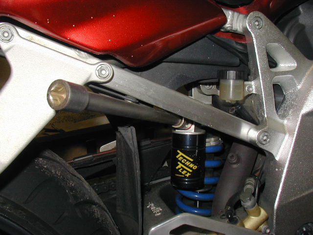

Well finally got a replacement for my old shock unit but is it the right one? Well it fits OK only problem is the reservoir is no more than 2mm from the Exhaust now that cant be right surely.

I'd suggest you may have it the wrong way round. Not that I've seen one as I have the ohlins. I'm sure Bef should be able to help out.
By Befbever on Friday, October 04, 2002 - 10:39 pm: ![]() ![]() ![]() |
Oh no, not again!
Dave had the exact same problem with his shock. I saw it and it can't be right IMO. I have plenty of clearance left on mine. Dave should have got it sorted at the UK importer's but he failed to let anyone (i.e. me!) know if he ever did. You listening Dave?
I asked Alice from Technoflex about the outcome recently and she hadn't heard anything. We therefore assumed the UK importer sorted Dave's shock out.
So I'd say don't go putting any dents in the exhaust header and call your UK importer first. Mailing to Holland is futile. They can't fix it from up there.
Hope this helps and please someone let us all know what the f*ck is going on.
Le Bef, a little upset.

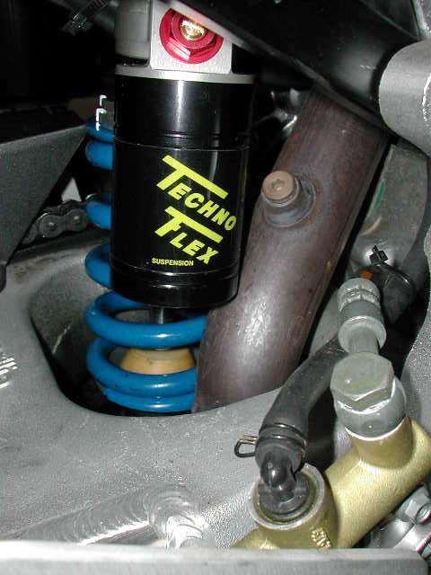

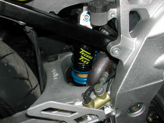

To check the alignement, Bef took photo's with a socket attached to the adjusters and an extender.
John, yours looks the same as mine ie on the bottom adjuster the extender won't fit past the bottom rail of the subframe. Bef can get a finger between the bottom of the reservior and the header.

Thought as much the angle of Bef�s reservoir is set further away from the header than on mine that obvious. Me thinks that someone has mixed the part numbers up at the factory.

Gee, thanks Dave, it would seem John is right about the parts. I thought the same about your shock at the time and now it seems I've got the only proper shock!
I'm sending this on to Roy to take a look at. Will let you know asap.

Found another pic of the top of the shock, well I don�t need a measure to see there is a difference
By Befbever on Thursday, October 10, 2002 - 11:08 am: ![]() ![]() ![]() |
Yeah, they don't look the same to me either.

By John1000 on Thursday, October 10, 2002 - 11:17 am: ![]() ![]() ![]() |
I have found enlightenment O wise one.
By Befbever on Thursday, October 10, 2002 - 11:59 am: ![]() ![]() ![]() |
Well done, Grasshopper.
Now what we see is the reservoir being suited to hop into the swing arm cavity if the need should arise.
Which, I can assure you, mine can't! Not by a long shot.

H E L P me friends!!! I just came back from vacation and was very happy to see my new shock from Technoflex had arrived. I almost can't wait to mount it, but now I see the last posts and don't know if I shall try to mount it or send it back and hopefully get my money back (I bought it directly from the factory and transfered the payment electronically), or wait for the new version.
As far as I can see I got the wrong one, but it is difficult to see on the pictures. Bef can you give me some measures I can check before I demount the old one?
Thanks in advance.
By Befbever on Sunday, October 20, 2002 - 05:48 am: ![]() ![]() ![]() |
There's no measurements I can give you as this is a difficult thing to measure. You need to check if the reservoir is rotated backwards enough from the top mounting point. Easiest thing to do is just fit it. It doesn't take all that long really.
Hope it works out.
By John1000 on Sunday, October 20, 2002 - 07:29 am: ![]() ![]() ![]() |
Take care fitting it make sure the rear wheel is dropped as far as possible and it will fly in, and don�t fully tighten the bolts as you will probably find it does foul the exhaust and you will have to take it back out (hope I�m wrong).
By Dave on Sunday, October 20, 2002 - 11:11 am: ![]() ![]() ![]() |
You've got it you might as well try it, Bef's got no problem with his, you might be luky.

Thanks all of you. I will try and mount it after work today. I will let you know the result.
I have discussed the problem with Roy (Technoflex)
and there is no problem in returning the shock and get the modified one, if it doesn't fit.
It seems to me they are very serviceminded at Technoflex and can only recommend them so far.
By Falcofreak on Tuesday, October 22, 2002 - 09:29 am: ![]() ![]() ![]() |
Hello again Falconfans.
The test is done and unfortunately with negative result..
I'm going to send it back tomorow hopeing to get the modified one soon.

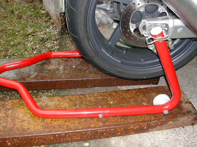

I must admit it was very easy to mount and demount, but you have to lift the bike very much to put in the Technoflex. (I used a small crane in our workshop in the company and put a rod through the swingarm as descriped by Bef and a pc. of robe(thanks again Bef)).
Unfortunately the winter is very close and I doubt I will get many opportunities to test the modified one
By John1000 on Tuesday, October 22, 2002 - 10:02 am: ![]() ![]() ![]() |
The easiest way to lift the back up is to put a plank or block under a paddock stand, lifts the back up high enough to put the stands under the bar through the swing-arm.
By Exdukenut on Tuesday, October 22, 2002 - 04:21 pm: ![]() ![]() ![]() |
God you've got a lot of extra weights, to balance the tyre!!!! I can't read the brand, but Bridgestones on my bike have 2 weights only.
