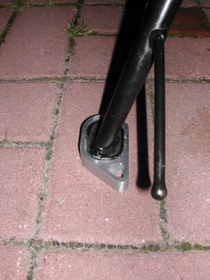

By Crmc33 on Monday, September 30, 2002 - 09:45 am: ![]() ![]() ![]() |
Finally got round to taking a pic of my little masterpiece. Its a bit rough n ready at the mo (I'll anodize it eventually), but the main thing is it works! The bike has a perfect angle of dangle and feels much more stable. It would of course look neater without the Cadwell scrape marks on the original stand base!

Nice piece of maching Mr C!
Could use one........
Gonna try to copy it , do you have a drawing or CADfile for me?
Hansie
By Andyjfalco on Monday, September 30, 2002 - 12:00 pm: ![]() ![]() ![]() |
Are you in the market to make me one??? I'd obviously cover any costs.
I think it's the best looking solution I've seen to the problem. Cheers,
Andy.
By Befbever on Monday, September 30, 2002 - 12:13 pm: ![]() ![]() ![]() |
Congrats, Crmc33, but is it attached somehow? Or do you put it in your pocket and take it out when you need it? Won't the bike fall over while you're looking for it?

By Crmc33 on Monday, September 30, 2002 - 11:40 pm: ![]() ![]() ![]() |
The plate currently attaches via a M6 bolt.
I Should be able to make some more, but to avoid the wrath of Hammy etc, please email me

Looks good Crmc, same principle as mine but a damn site neater.

I'd advize some Loctite when fitting the bolt tho, Crmc33. Lots of vibration (and temperature stress?) in the side stand area.
Good thing is you don't have to re-spray the side stand after fitting it, contrary to welding.
Only downside (not for me, I think it's perfect! ) may be the fact that you have to cut a 6 mm thread into the base, if I understand correctly. Might be too much to ask from some people.
