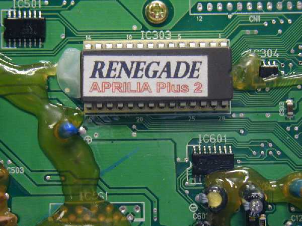

I (or should I say 'her indoors') has broken 4 prongs off my BBpower chip when removing it from the ECU.
Ive fitted the OE Falco chip back in its place. Is anyone out there running the original OE chip with the Rene airkit and race cans such as the Aprilia SL Carbons?
I havent had chance to test the bike since fitting the OE chip but I'll report back with my findings. I expect theres plenty of owners who are currently running this setup. Please comment on performance if you do.
Does anyone know if the chip prongs can be repaired successfully (its the chip daughterboard prongs that have actually broke)? I guess the simplest option is to get BBPower to fit a new daughterboard to the chip?
Im at Cadwell in a couple of weeks so I would like my chip back in if possible!
Any comments welcome, particularly ones that verge on being serious.

I was discussing the BBPower chip with the manufacturer and had the ECU box out to check the serial number so that he could tell me exactly what maps were on it. During this little investigation I was tempted to remove the chip and try the OE chip to see the effect on top speed / top end power (ready for the track day) and my wife offered to carefully remove the chip. In doing so she kindly removed the chip/daughterboard and bent half off the fragile prongs almost flat. Many of them snapped when I bemt them back.
I have now sent the chip back to BBpower and he is repairing it for the price of the postage. Very good customer service I reckon.

....and my Falco wouldnt start this morning (at all). It turned over the engine (no not upside down) but wasnt interested in firing. Oh dear what has she done!
many flicks at the kill switch, sidestand and reconnection of the battery made no difference at all. Oh dear. I cycled to work.
My guess is my original chip is b'loxed. Am I right in thinking that the original chip has no daughterboard between it and the main ECU board?

Yep. The Renegade Eprom goes where the stock chip was.

I found the problem with my OE chip. It has a prong missing at one end (hard to tell at first sight) ...the dealer must have broken it last year and 'accidentally on purpose forgot' to mention it. Its odd cos the prong has snapped off directly at the chip interface so theres no way of repairing it either.
Im not even gonna try n argue with the dealer who did it cos I can guess his reply.....
TBH Im just glad that I have an explanation why my bike wouldnt run yesterday and was sending flames out of the pipes the length of the street, at 7.30 am!
By Crmc33 on Tuesday, August 20, 2002 - 11:11 am: ![]() ![]() ![]() |
Youll be glad (I hope) to know that theres one more booming Falco on the road tonight. The chip is fixed and the bike is back to its awesome self.
