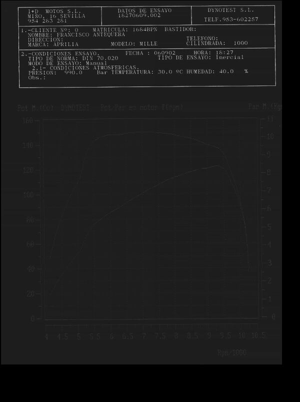

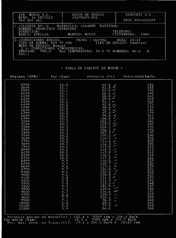

Hi riders,
I've got one problem - thats not true, Ive got more than one but the others don't make me keep awake.
My Mille is slow... she only runs 151 mph and Im sad
A weeks ago I dynoed my bike abd I had this
and this one
Im sorry for the quality but its not my fault...
I want to share my thoughts with you and know your opinions...
1) The power curve looks quite different to other that I have seen about Mille. I think thats is very strange...
2) In my opinion, the power is not completely good for a standar derestricted bike but I think its not very bad neither.
3) I think the engine run down very quickly, take the max power at 9350 and the power falls off very quickly too.I have seen lot of Mille dynos , at Renegade and at other sites, and usually the engine keep the max power from 9000 to 10500 and my engine falls heavily at 9500...
Please if you have time tell me what do you think about these question and what could be happenning...
Thank you for your time.

Interesting that your dyno speed at max power is 246kph, approximately the same as the 151mph you have stated on your thread.
Are you sure the exhaust restrictor has been removed. Your power values look healthy enough its just that they dont hang on at the top end of the rev range all that well. Most Mille graphs Ive seen hold onto the power until about 10000rpm.
Maybe your chip is different as well?

Just checked my dyno to compare, and yours is making good power, so no complaints there I hope. But mine doesnt really drop off till 10,400 rpm.
Maybe your Max rev light is set to 9500rpm and the dyno operator got to that rpm and wound of the throttle, thinking it was redline. That might explain the curve (But not your low top speed).
On the road, does your power drop off after 9500 rpm when you rev it out in 3rd or 4th?

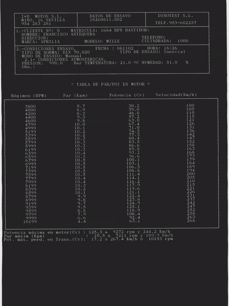

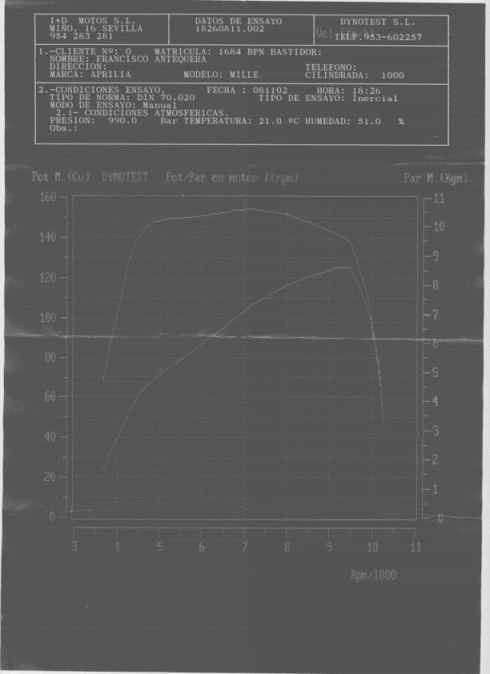

More news about this question:
Today I received the bike from the dealer after the 15000 km service and I was surpeised when I checked the bill and can find nothing about the tapped clearance checking.
I went home,I checked some points and I find they have not changed or clean the air filter. I was completely dirty ant the airbox have rest of oil ti the floor.
After that I found the diagnostic connector.I was looking for him a lot of time but it was not near to the ECU as I suppoused, it was in a long wire passind the battery. I connected it and I was surprised about the diagnosis message.
I found the "1" in the dealer mode diagnostic.
and everytime I went him to talk what happens he tell me that everything is OK and that were the real performance of the bike.
I think that means a bad TPS setting so now I´m looking for information to make it myself because my dealer has lost all credibility for me.
I hope this can explain the poor performance...
WHat do you think?
Paco.

Francesco, it would appear that your dealer is erm...not very knowledgable. He should at least check the valve clearances (although they rarely need adjusting) and fit a new air filter.
The oil deposits in the airbox are quite normal as they come from the crankcase breather tube.
But don't worry about the "1" diagnostic too much. Try this: connect the diagnostics connector, twist the throttle and let it snap back. You'll find that the values may change from "1" to "0" or "-1". The TPS is very sensitive but doesn't affect any top speed performance that I know of.
Since your dealer isn't too bothered about replacing an air filter, chances are he doesn't know how to set up an RSV, and that may very well be the answer to your bike's low performance.
Call Jorge, I'm sure he's fluent in Spanish.

I made as you told me, I twisted the throttle and let it snap back. I repeat that aperation around 14 or 15 times and always shows "1" for me.
I suppouse that in my case the TPS could be a little more out setting than in others.
I think that the injection time is mapped in the eprom like a three coordinates system:
X - the rpm
Y - the TPS position
Z - the injection time
with this basic map the ECU make correction with the air pressure, temperature...
So i think that if thats not imortant for the poor speed perhaps could explain the bluntness of my engine. Other Milles that I had tested are smother than mine.
In each case the problem is the whole situation, a dealer that no check valve clearance, changes or clean air filter. Probably he only changes the oil, and I dude if the changes the oil flter...
And when I told him about the poor performance of my Mille he told me that thats their performance, and no more explanation...
Now I´m looking for other garage to make the maintenance. Unfortunately Renagade is too far from Sevilla ( south of Spain ) to go there as I would like because I completely sure thats the place to go...
Perhaps Jorge knows a good garage near from me. I know he works with Oliver Team and 'Gallo' Riquelme Team and was a few year here...
Jorgeeeeeeeee!!!
During this conversation has just arrived ( it´s true ) a new eprom for me. It's an Arrow one.
This was one of the test that I want to do: change my eprom to see if is there any problem in it.

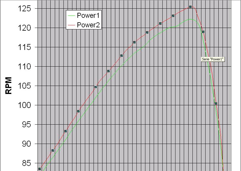

Geo,
before test the new eprom I want to tell you that I´m sorry about you were in the same situation...
I know four, five people with the problem ( you, Alex in Grece, Karlheinz in Germany, Stan in USA, me...)
I would like that all of us inform the others about how is going to everyone and try to find a solution.
I know that we could have different causes with the same problem ( poor performance ) but I think that if we comment all test we made we can show a way to the others...
In my case my bike never had a good performance.
Sometimes I think about a bad assembling of the camshafts or some extrange cuestion like that.
In your case is clear that must be other kind of problem because your bike runs well before.
Something like one electronic sensor that is not working adequately.
In each case I need to find a good garage that can reset my TPS, synchronize the injection and make a CO setting.
And now in going to test my new eprom...

By Klingon on Friday, November 08, 2002 - 01:23 pm: ![]() ![]() ![]() |
Hi riders,
First of all and in importance order, I hvae to say that my culo is safe, don't worry !
Second of all, I have dynoed the bike today and here are the results:
In this one you have compared The bad TPS setting (green) and the better one (red).
The feeling on the road are much better than dynos can show...
By Klingon on Friday, November 08, 2002 - 01:25 pm: ![]() ![]() ![]() |
Ok again
By Klingon on Friday, November 08, 2002 - 01:28 pm: ![]() ![]() ![]() |
One more
By Klingon on Friday, November 08, 2002 - 01:32 pm: ![]() ![]() ![]() |
The data
By Klingon on Friday, November 08, 2002 - 01:37 pm: ![]() ![]() ![]() |
And a comparative graphic made in Excell with the tables data.
Green - Bad TPS Setting (1 code)
Red - Good TPS setting (0 code)
After this run we made a new one, the bike offers 1.2 HP more but the printer died. I hope anothe day take a copy...
